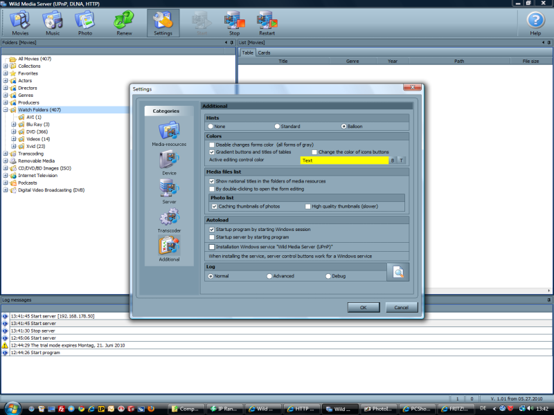

Settings - Additional - Autoload - turn off "Installation Windows Service" - Ok - Start server - check "Log messages".
wildone1965

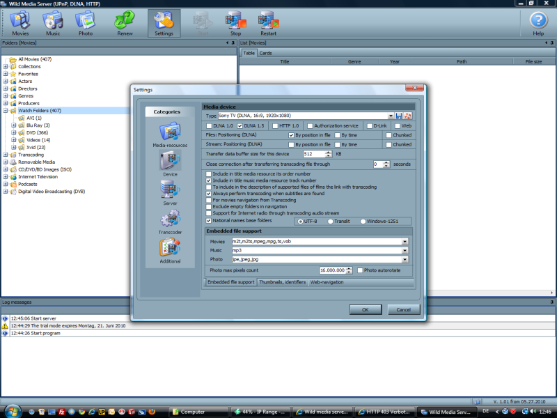

Re: Can't access WMS from Sony Bravia KDL 46 EX 505 TV
Post by wildone1965 »
Unfortunately still no access via webbrowser. Screenshot below
wildone1965 wrote:Unfortunately still no access via webbrowser. Screenshot below
Settings-Server-"A list of allowed network connections" - remove all or add webbrowser computer.
