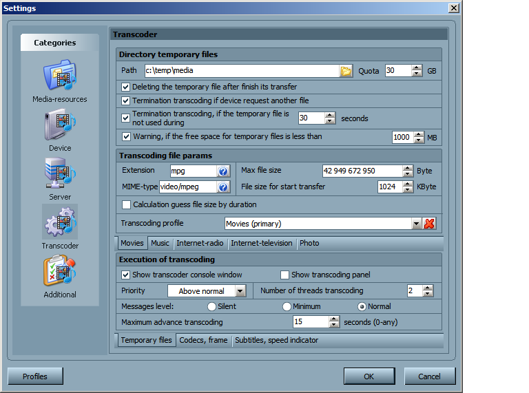

Movies (primary):
primary config2.png (68.33 KiB) Viewed 19691 times
VLC:
as posted above
DON'T MISS THE POST BEFORE
EDIT:
Movies (primary):
nearly not lagging on low resolution vids... (one or two 1second lag from middle - than increasing)
vids like: "Eyes Set to Kill - -liar in the glass- music video.AVI"
but with vids like: "Scooter - Ramp (the logicalsong).mpg" or "Simple Plan - When I'm Gone [2008][SkidVid]_XviD.avi" it is lagging from the beginning till end with maybe 5seconds normal playback...
(the most tested profiles do not work -> console closing at start or not opening)

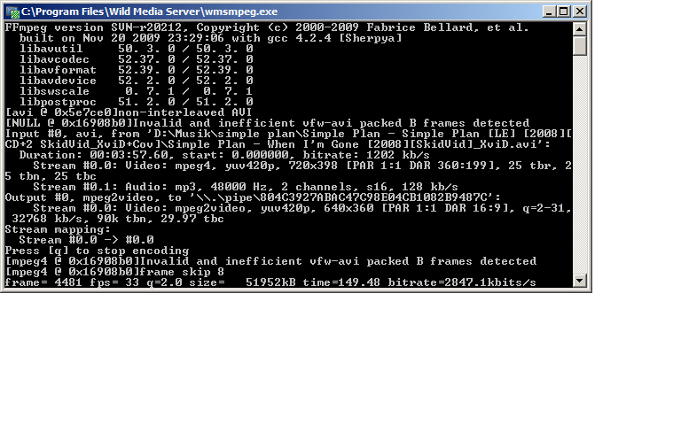

DEvil HUnter wrote:Movies (primary) - MPLEX:
The attachment mplex.png is no longer available
then getting an error, console windows are closing...
to fast to get screenshot..

DEvil HUnter wrote: Movies (primary):
(this one i used before switching to vlc)
fps rate continiusly decreasing, holding by about 40...
vid is lagging extreamly...
Reducing the speed transcoding is normal, this happens because of this setting
Re: VLC
Perhaps the problem because of this,
primary config1.JPG (78.19 KiB) Viewed 19684 times
it is better to clear this field

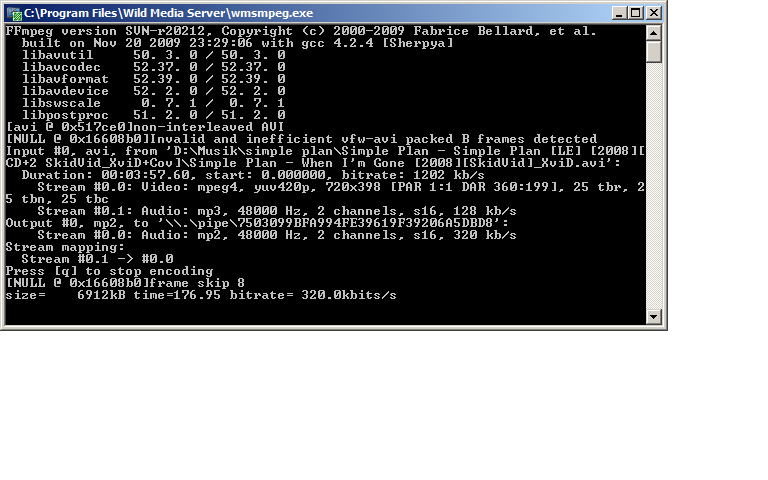

Mplex:
(this time with mp2)
ok till middle of vid...
than beginning to lag...
and near end only a big lag...
but it seamd to start better than normal primary
i tryed Movies (additional):
a bit better...
your suggestion to clear the frame rate field:
i tryed it but it has no effect...
other thing:
i also tryed to take mp2 not mp3 - this helped a lot!!
but for a better quality i altered the vid bitrate value to 32768000 bit/sec...
than it had only a little lag random position in first maybe 30 seconds... lag was about <1second...
rest of the vid played fine... transcoding was finished about half of the vid (additional)...
with primary there is more than one lag and it they are longer...
so it seams to me that this is a mix of the two problems:
1. mp3 transcoding is not fast enought or somthing with the config...
2. with primary the framerate is dropping to low.. (maybe also because i send it via wlan -> collisions? -> time loss?)

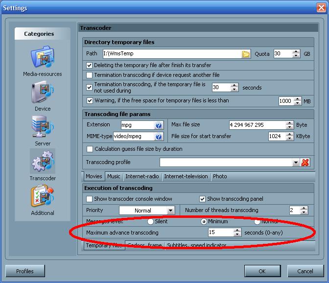

Recommendations:
1. Off mode "Termination transcoding if device request another file"
2. Set the field "Maximum advance transcoding" - 0
3. Clear field "Frame rate"
4. Do not use wlan (at least at the testing phase).

Eugene wrote: Recommendations:
no vissible effect...
