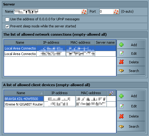

Start server.
Settings - Server - "The list of authorized client devices" - Search - TV is on the list?

Yes. I do a "Search", and see this:
I then click the X so that both get a green "v" (I have also tried without allowing the router), and click OK.
Note that I have an active VPN connection too, although this never caused problems before:
I also tried deleting both entries in the top box (to allow all). And also leaving just the TV in the box below.
I have a D-Link router, and noticed a "D-Link" option. Is that relevant at all? It's unchecked under the "Sony TV" profile.
Thanks for your help so far...

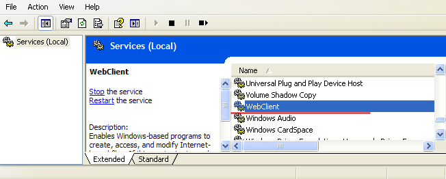

I am on Windows XP, and ran "services.msc" from the Run dialog. I looked through the list of services, but could not find "Wild Media Server". Is this the right way to look for it?
I guess it should have been shown where the red line is in this screenshot:
