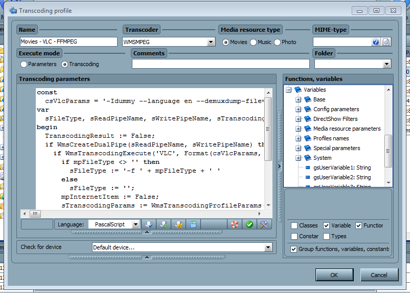

That did not work for me, perhaps I misunderstood and applied the incorrect settings. Would you please check my work?
[0219cd84] dummy interface: VLC media player - 1.1.4 The Luggage
[0219cd84] dummy interface: Copyright c 1996-2010 the VideoLAN team
Warning: if you can't access the GUI anymore, open a command-line window, go to
the directory where you installed VLC and run "vlc -I qt"
[0219cd84] dummy interface: using the dummy interface module...
[02179b94] mux_ps mux: Open
[0256344c] access_http access: Raw-audio server found, nsv demuxer selected
[02192474] packetizer_mpeg4audio decoder: AAC channels: 1 samplerate: 32000
[0219ad94] main stream out error: Failed to create audio filter
[0219ad94] stream_out_transcode stream out error: Failed to find conversion filt
er for resampling
[0219ad94] stream_out_transcode stream out error: cannot create audio chain
[02192474] main decoder error: cannot create packetizer output (mp4a)

List [Movies] - select media-resource - right click - Transcoding profile - "Movies - VLC - FFMPEG"
Isaac
Posts: 29
Joined: Sat May 22, 2010 3:05 am
Re: no longer access InternetTV after VLC upgrade
Post by Isaac »
Eugene wrote:List [Movies] - select media-resource - right click - Transcoding profile - "Movies - VLC - FFMPEG"
That does not work, when I test transcoding manually I'm prompted with a y/n.

My transcoding folder not contains spaces, I made changes in script.
Isaac
Posts: 29
Post by Isaac »
Do you mean
Settings-Transcoder-Directory Temporary Files Path?
