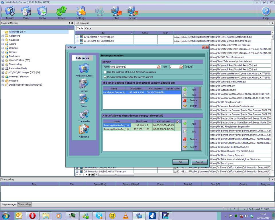

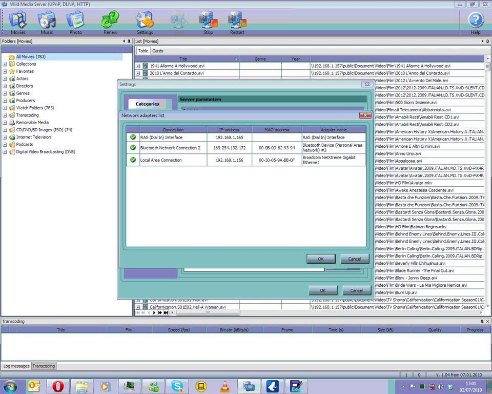

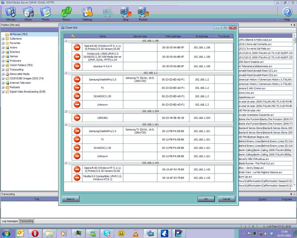

here there are the snapshots.
Settings-client-search (Medium).jpg (142.23 KiB) Viewed 11354 times
Settings-Server-search (Medium).jpg (133.96 KiB) Viewed 11354 times
Settings-Server (Medium).jpg (142.36 KiB) Viewed 11354 times
Re: Slow Start on W7
libero wrote:here there are the snapshots.
Have you tried to disable other UPnP-servers (applications) ?
