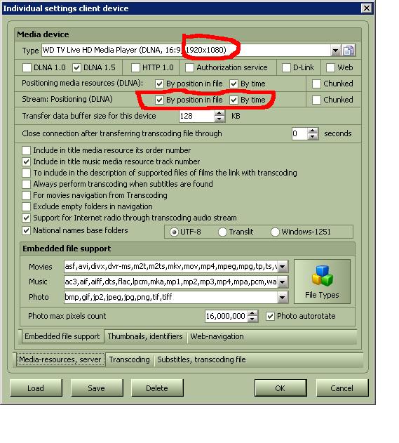

I may have fixed it ?!?!
I changed and enabled the settings I have circled in red here:
I changed the "resolution?" in the WDTV Live description to 1920x1080 becase that is what the WDTV supports...
Note sure exactly what those check box settings do, I was just trying things out...
But all my problem files now seem to work when streamed over WMS!!!

Re: Streaming bug?
brettich wrote:I may have fixed it ?!?!
No, is simply the name of configuration. "720x406" - comment for the transcoding frame size.
brettich wrote: Note sure exactly what those check box settings do, I was just trying things out...
Probably you re-selected device configuration and all settings become default. Perhaps you had enabled "Always perform transcoding then subtitles are found" - this could cause transcoding and problems with playback.
