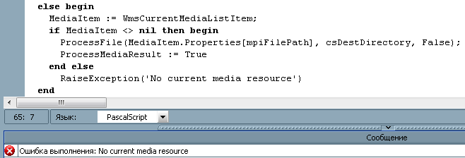

I try to pre-transcode a file with Shift+F5, but I get an error every time (screenshot).
How to make pre-transcoding work?

Step-by-step execution doesn't help. I can't set the "WmsCurrentMediaListItem" in steb-by-step mode. See attachment.
Anyway, this standard script doesn't work for me - the "WmsFileTranscoding(aSourceFileName, sDestFileName, csTranscodingProfileName)" returns "False" without any comment.
