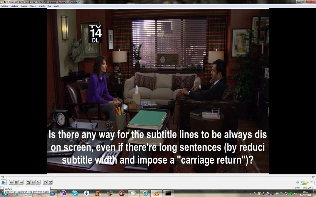

1
00:00:06,798 --> 00:00:08,884
Is there any way for the subtitle lines to be always displayed on screen, even if there're long sentences (by reducing the subtitle width and impose a "carriage return")?

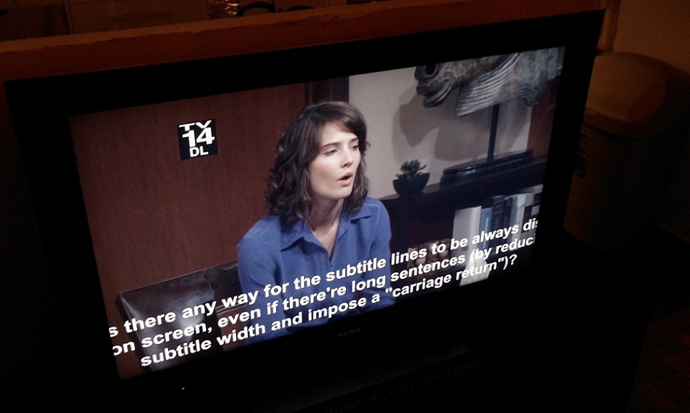

Re: Subtitles go out of the screen
Thanks for giving me confidence in finding a solution by proving it's possible.
Did i modify a field somewhere ?
I know you're the man!
Here's what happends on my TV:
Possibly this is the result of scaling, the device has a mode "Original frame size" (or something like that) ?
Settings - Devices - choose a device - Settings - Transcoder - "Codecs, frame" - Frame - "Active padding color" - select a color, other than black, that the device will not be cut.
I've tried the "Active padding color" thing, same result.
It may help you, it's cut on the right side of the screen only...
About the Frame Size: it's on "Minimum, fit to the screen"
Any other ideas Eugene ?
Thanks again
Niko
Thanks again
Niko

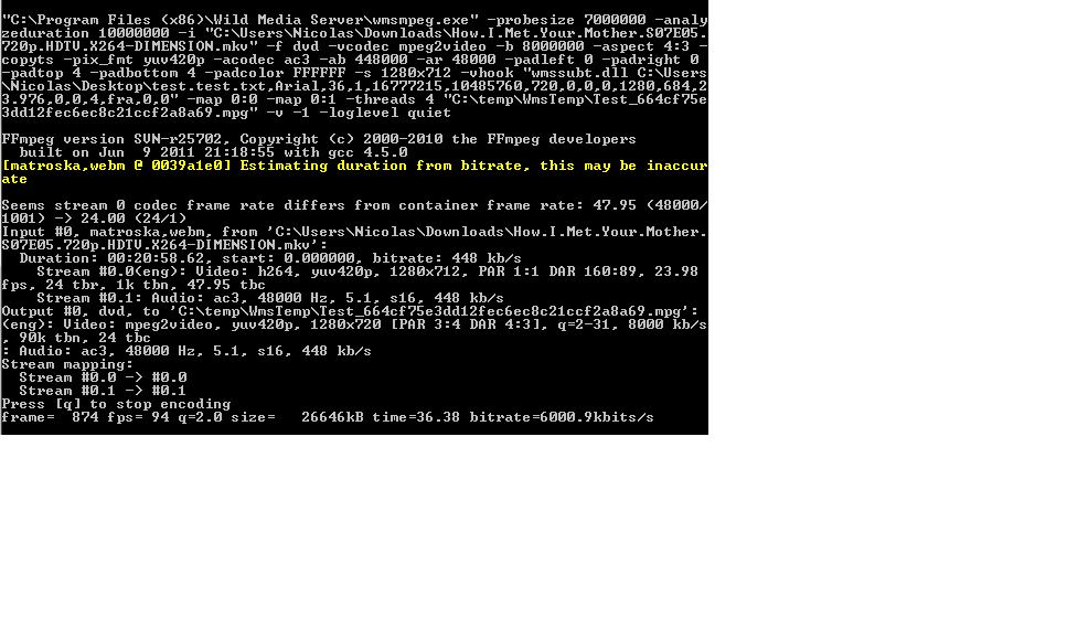

Select a file - right click - "Test transcoding" - your device
What are the parameters of transcoding ?
Hi There,
The usual profile is "movies (additionnal)"
Here's the dos windows when testing:
