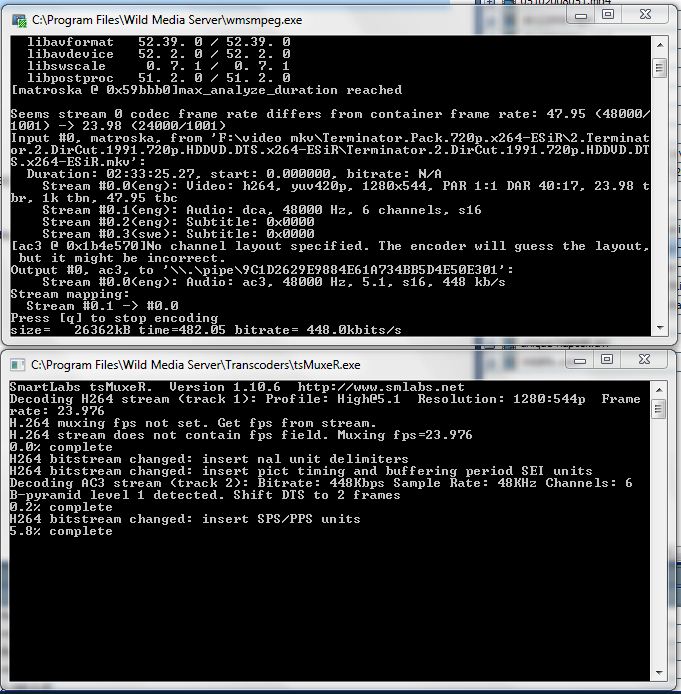

Hi Eugene
one more question....
Samsung B series (LE40B750) support MKV native, but no DTS audio track......
optimal config is demux - transcode DTS to AC3 and mux back -play....
I check on the fly profiles:"Movies (primary)" a "Movies - TsMuxer"
"Movies (primary)" work great, but transcode audio and video - more power on procesor needed (not work on old PC)
"Movies - TsMuxer" is more sophistical....but do not work corectly for samsung TV..... demux - transcode DTS to AC3 and mux work fine, but destination m2ts file Samsung TV not play correctly video is jerky, frame rate up and down.... not good
I made test file with test transcodig function and copy him to USB HDD and play on TV directly - output is the same (jerky, atd.......)

rommi wrote: one more question....
Original file without sound is played normally?
Any problems when transcoding I do not see. You can try to use the profile "Movies - DirectShow - TsMuxer", to decode the audio requires FFDShow.
P.S. LE40B750 - 200Hz LCD TV ? It may be necessary to align the frame rate to 24 or 25.

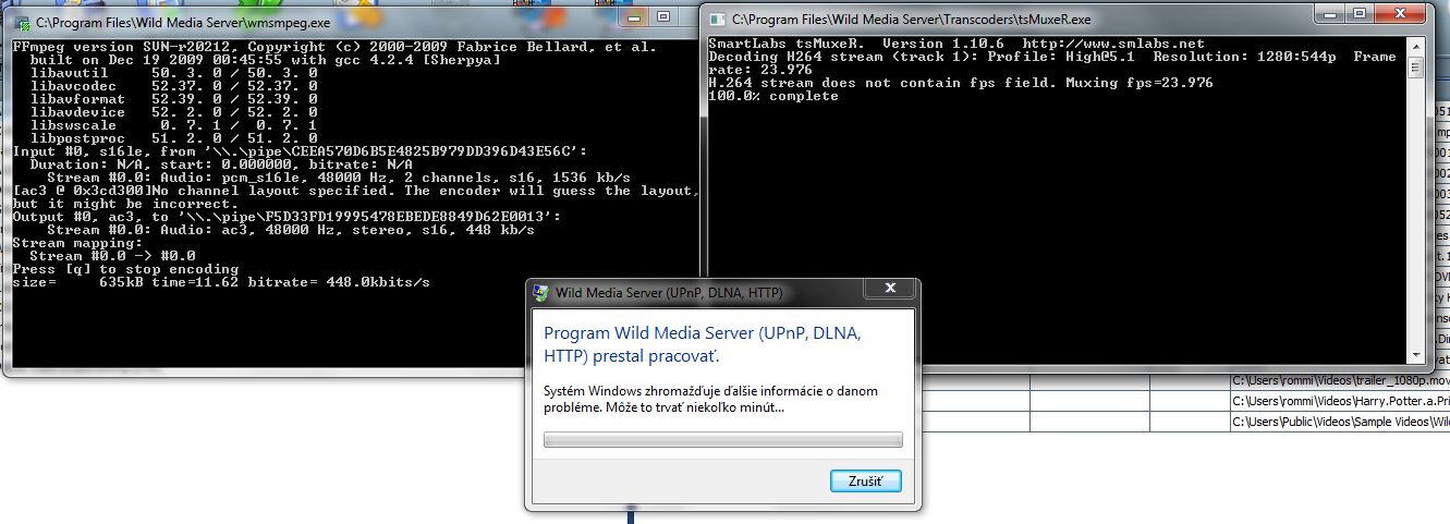

Hi
..Yes origina MKV file (wo sound of course..) play normaly. frame rate 23,976 is not problem.......
I installed ffdshow - latest release from http://www.free-codecs.com/download/FFDShow.htm version wo MMX and SSE
1. I aply "Movies - DirectShow - TsMuxer" profile for the same movie and result is..... WMS crash... :-) (see image)
2. I aply "Movies - DirectShow - TsMuxer" profile to another MKV file with AC3 sound track - muxing work, but video is jerky (the same as "Movies - TsMuxer")and sound is out of sync cca 1,5-2 sec after video....

Re: Samsung TV B series streaming mkv DTS
rommi wrote: I installed ffdshow - latest release from http://www.free-codecs.com/download/FFDShow.htm version wo MMX and SSE
Fix will be in version 0.72.1
