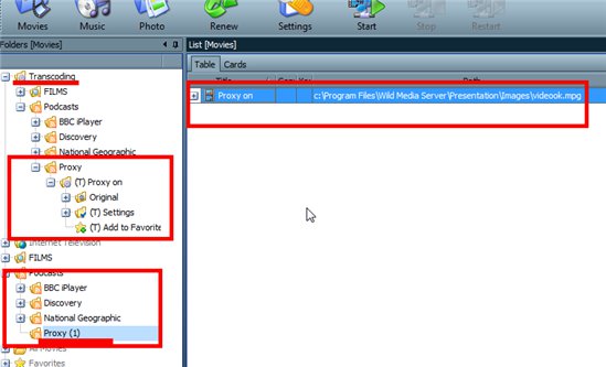

Re: BBC Iplayer with Expat Shield
Select the folder "Podcasts" - right click - Add folder - Title: Proxy - Ok
List [Movies] - right click - Add link
Title: Proxy On
File: ?:\Program Files\Wild Media Server\Presentation\Images\videook.mpg
Ok
Settings - Transcoder - Profiles - Transcoding profiles list - Add
Language: PascalScript
Transcoding parameters:
  Sh: Variant;
  Sh := CreateOleObject('Wscript.Shell');
  Sh.Run('notepad.exe');
  TranscodingParams := WmsTranscodingProfileParams('Movies (primary)')
notepad.exe must be replaced
Ok - Ok - Ok
List [Movies] - select "Proxy On" - right click - Transcoding profile "Proxy on"
"Proxy off" done similarly to "Proxy On", notepad.exe replaced with "taskkill /F /IM notepad.exe" (probably without /F, taskkill /?)
To enable or disable the proxy, select playback of the corresponding resource on the device.

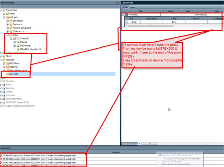

it works for 50 %
If i activate de proxy in WMS (as shown at de picture) it will activate Expat schield. But if i try to activate on my device it won't work.
Thanks in advance Eugene
or should i say: спасибо ;)
I have no problems with playback from device. At a minimum, the wrong path (on screenshot).

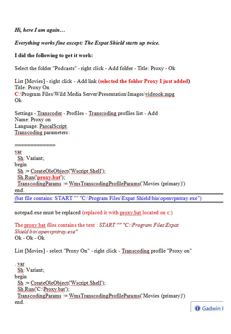

Post by meram »
супер! It works!
The only thing i still have to figure out is that it runs Expat shield twice, maby Eugene has an solution?
Here is a send-screen for other people to show what I did. (I have Win 7 and a Sony 37KDLEX500 and a LG NAS server)
Thanks for your help Eugene, you made a great program!
Greetings from the Netherlands
:P
last issue 2.jpg (28.57 KiB) Viewed 25015 times
meram wrote: The only thing i still have to figure out is that it runs Expat shield twice, maby Eugene has an solution?
  Sh, shExec: Variant;
  sTaskList: string;
  shExec := Sh.Exec('tasklist /FI "IMAGENAME eq openvpntray.exe"');
  sTaskList := '';
  while not ShExec.StdOut.AtEndOfStream do
    sTaskList := sTaskList + #13#10 + shExec.StdOut.ReadLine;
  if Pos('openvpntray.exe', sTaskList) = 0 then
    Sh.Run('C:\Program Files\Expat Shield\bin\openvpntray.exe');
