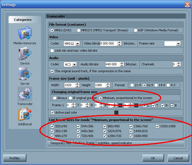

Try to include these settings
DEvil HUnter wrote: b) the vid normaly has a other size then the transcoding output. the missing parts (normaly left and right side 4:3 -> 16:9) are gray on tv. this looks not very good.

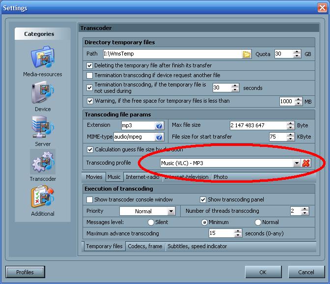

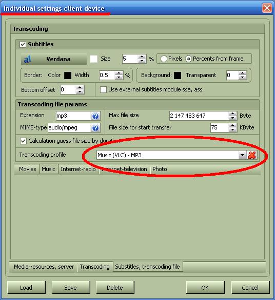

to my first question:
(streaming from vlc to wms and from wms to my showcenter)
i have allready tested the suggested configuration...
maybe i missed the point or you don't get my question right...
i would like to start a stream in vlc.. than tell the showcenter to start vlc strem (which tells wms to stream the vlc stream to the showcenter)... wms in the middle is needed because the showcenter only supports upnp av for handling the streaming.
but in your configuration answer to my first question it is all about transcoding - not passing a http or mms stream..

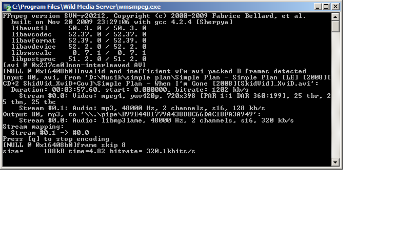

the pic shows the errors:
yes i tryed to increase the cache but it had no effect - maybe i did it wrong...
The attachment temp.png is no longer available
EDIT3:
with some files i get this:
The attachment test.png is no longer available
What are the parameters of the source file?

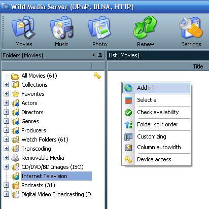

first question:
i don't get it how to add a http stream to the movie list...
so i can't open the edit info dialog on it...
if i click right on the internet television i have no option add - or something like that...
