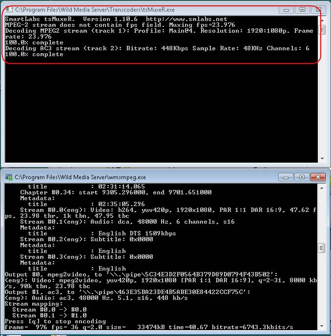

I think that's a problem in TsMuxer because sometimes to the same video file it shows more information. The two printscreens below is for the same video:

I'm taking new tests and detected when i use the "Movies - TsMuxer" profile, nothing shows on TV. Only when i set to "Movies (primary)-<some resolution>".
When i set "Movies - DirectShow - TsMuxer", video and audio are fantastic, but the subtitles don't, load. (I've already checked the FFDshow video decoder configuration, and Subtitles is enabled)
But here is the point. When not using TsMuxer, the video quality is poor and
i can see a little lags.
I really need help to play these .mkv files on my TV through TsMuxer.
