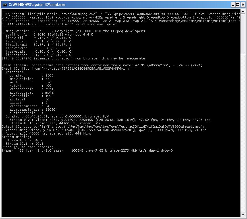

surfingsmurf wrote: Only problem I can't seem to get it to play anything. I keep getting "video file cannot be played". I'm running the latest update.
Maybe solution http://www.wildmediaserver.com/forum/vi ... 1624#p1624
I'm able to view video from cnn and dailymotion, but others I can't like theWD, TV.com, etc.. It keeps coming up with "video file cannot be played". Any suggestion?

yes, I'm in the US and attached is what I get when test transcoding

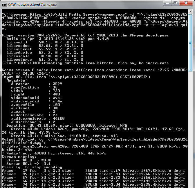

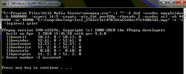

surfingsmurf wrote:yes, I'm in the US and attached is what I get when test transcoding
How did you update the wdf file? When I updated it via 'Load from file' menu, it had not really updated it. I had to remove Hulu folder and drop the hulu.wdf file again.
Your command line is different: it does not have "\\.\pipe\..."
