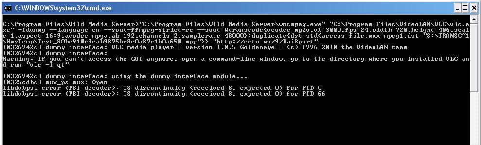

I'm getting this error when I do 'test transcoding':
[0x9a4c0c] dummy interface: using the dummy interface module...
libdvbpsi error (PSI decoder): TS discontinuity (received 12, expected 0)
D 0
D 66
[0x99ef2c] main mux error: cannot add a new stream (unsupported while mux
this format). You can try increasing sout-mux-caching value
[0x9a09dc] stream_out_transcode stream out error: cannot add this stream

Eugene wrote: I tested using the transcoding profile "Internet-television" (if the settings change, then the choice on right-button mouse)
I tried that, no luck :(
same error message.
Do you select 'Test transcoding > Default device ...'? What happens after you do so? Does VLC open?

In the directory of temporary files of transcoding, you can check the created file
Wow yeah the temp file is created but the Xbox360 complains about Status Code: 69-c00d36b4
