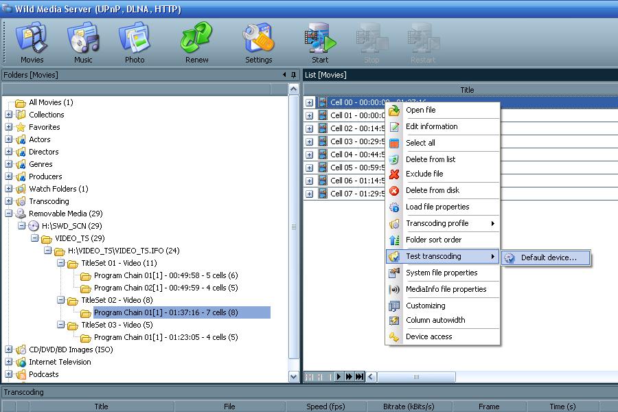

Are there any step by step instructions on how to transcode to a file direct from a DVD? I've tried just about every way with no success.
Cheers.
Re: Movie playing time
maybury wrote: Are there any step by step instructions on how to transcode to a file direct from a DVD? I've tried just about every way with no success.
1. Select DVD-cell.
2. Start test transcoding
