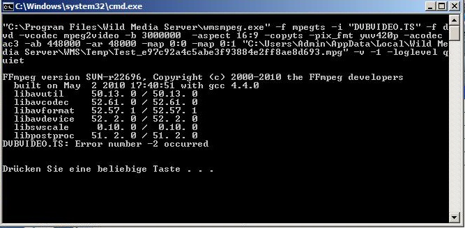

Hello, thanks for your Reply, i'm a amateur in case of Wildmediaserver.
At first the netgear client shows behind the tv channel name (access:fta) when i click on the channel, the netgear client told me that "Detect this Media format is not possible"
Know to your questions, when i click on the test transcoding
Error number -2 occured is shown.
for detail information about this test transoding see my attachment, there you can find i screenshot from this test.
Best Regards Richard.

Re: Watch TV Channels (dvb-s) on a upnp Client
On the right click mouse choose transcoding profile "Digital television (DVB) - DVPiper", "Test transcoding".pucapg wrote:Hello, thanks for your Reply, i'm a amateur in case of Wildmediaserver.
