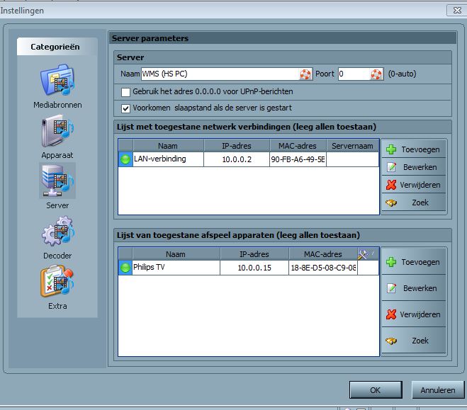

On the server tab there is only the TV in the list, nothing else (see image). So why it is slow I do not know.

- Knipsel.JPG (72.87 KiB) Viewed 10855 times

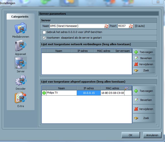

I do not know what to look for on the list of networks, I will add the current setting window to this post. I set this a few days ago, on your advice, just one interface(- the only one I have active BTW). I am guessing this is ok?

- Knipsel.JPG (73.56 KiB) Viewed 10822 times
