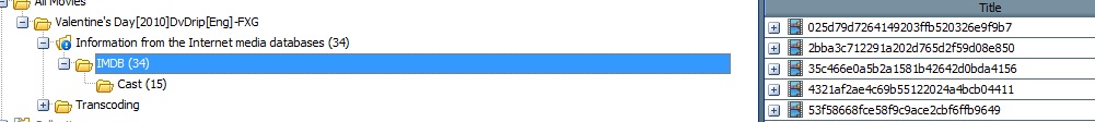

Eugene wrote: From what the page (IMDB) is loaded the information ?
I see IMDB folder on TV but when enter inside I see the message "....server unavailable..."

Now I see the problem.
I didn't notice that I do not see correct characters on WMS.
It used to work earlier.

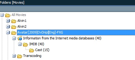

Post by oskarq »
Eugene wrote: Frankly, it is unlikely.
So I did something else.
I removed the resource and add again.
Everything was fine.
Then I added IMDB info to one of the movie.
After that the folder of that movie became unavailable tru the TV.
This is strange. It used to work.
So for now I skip playing with IMDB.
Oskar

After loading the information, Title of the movie contains a line break, may cause problems in this
