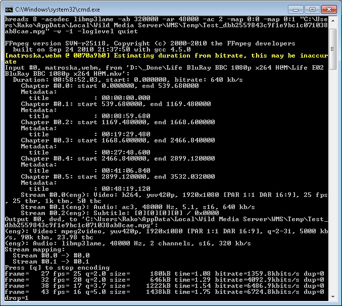

Attached is console from primary transcoding. FPS still goes down from 25, even below 13.
I guess machine is powerfull enough. I tried also pre-transcoding and set frame size to minimum but also no changes.
Pls. advice what do I do wrong or what should I change.
Rasto

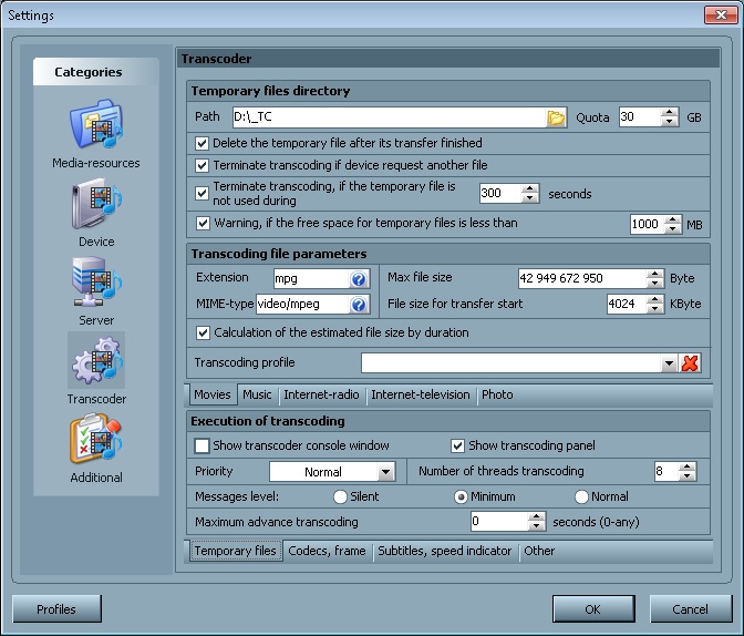

- transcoding config
- trans_config.jpg (133.09 KiB) Viewed 13853 times
Re: 1080p MKV transcoding with low FPS
Try to change the path for temporary files of transcoding (Settings-Transcoder). Specify a different disk - other, than use your system for the paging file.Rako wrote: I went through the forum trying to find anything to move forward but I can't help myself. My problem is that I'm still getting low FPS for full HD mkv.
hi,
I changed to D drive but result is the same. I left it couple of seconds and it went up to 9 fps. This makes me sad. Anything to try yet ?
Thanks in advance.
Thanks in advance.
- trans_config.jpg (129.29 KiB) Viewed 13834 times

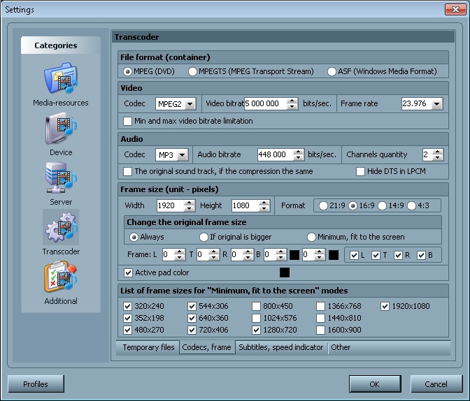

Settings - Transcoder - Profiles - "Movies - CoreAVC" - Edit - Position 83:45 - replace 'CoreAVC Video Decoder' to 'Microsoft DTV-DVD Video Decoder' - Ok - Ok - Ok
Remarks:
It makes no sense to use a frame size of 1920x1080 with video quality 5000
Use a laptop for video transcoding is not a good idea - the problem of overheating
Hard drive 7200rpm or 5400rpm ?
You can try to use the transcoding profile "Movies - CoreAVC" with the replacement of the codec 'CoreAVC Video Decoder' to 'Microsoft DTV-DVD Video Decoder'Rako wrote: I changed to D drive but result is the same. I left it couple of seconds and it went up to 9 fps. This makes me sad. Anything to try yet ?
Remarks:

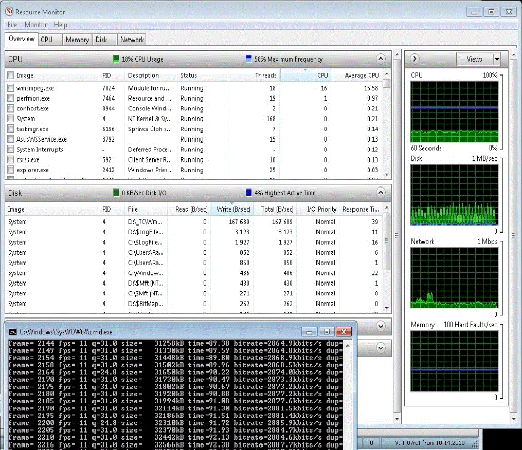

You mean bitrate? if yes, then you are right, I set it to 2400 but no change once again.Eugene wrote: Remarks:
I believe 4 cores core i7 and disk (5400 rpm) which can write over 80 MBytes/s to external USB3.0 disk and over 70MBytes/s on the disk itself (C->D) should not have problem with such load. It has even great reserves as shown on the snapshot. I checked temperatures also which are completely ok. In addition, on version 1.03 I was able to run properly some other mkvs which now I tried but now getting similiar results for all.Eugene wrote: Use a laptop for video transcoding is not a good idea - the problem of overheating
I will try this and let you know the result. Won't this affect quality ? Is there any description of all profiles what are pros and cons of each one? For me it's just blackbox. I found some matrix in the forum but it's just very general overview.Eugene wrote: You can try to use the transcoding profile "Movies - CoreAVC" with the replacement of the codec 'CoreAVC Video Decoder' to 'Microsoft DTV-DVD Video Decoder'
Anything that we could improve yet ? Did something change across versions or any setting yet ?
Rasto
- system load
- transcoding.gif (180.99 KiB) Viewed 13815 times
