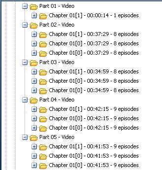

JST200 wrote: In your DVD example, are you saying that there is no one Cell that is identifed as the full movie?
Yes, TV programs, serials, karaoke, ...

1. Settings - Processing - Add -
Name: Creating DVD-links
turn on "Button on the main form"
Script:
procedure ProcessItem(aItem: TWmsScriptMediaItem);
  dtTimeLength, dtMaxTimeLength: TDateTime;
  i, j: Integer;
  CellItem, ChapterItem, MainCellItem, PartItem: TWmsScriptMediaItem;
  sDVDPath, sDVDTitle: string;
  if aItem.IsFolder and SameText(ExtractFileExt(aItem.Properties[mpiFilePath]), '.ifo') then begin
    MainCellItem := nil; dtMaxTimeLength := 0;
    for i := 0 to aItem.ChildCount - 1 do begin
      PartItem := aItem.ChildItems[i];
      if PartItem.IsFolder then
        for j := 0 to PartItem.ChildCount - 1 do begin
          ChapterItem := PartItem.ChildItems[j];
          if ChapterItem.HasChildItems then begin
            CellItem := ChapterItem.ChildItems[0];
            if SameText(CellItem.Properties[mpiFilePath], 'DVDVIDEO.VOB') then try
              dtTimeLength := StrToTime(CellItem.Properties[mpiTimeLength]);
              if dtTimeLength > dtMaxTimeLength then begin
                dtMaxTimeLength := dtTimeLength;
                MainCellItem := CellItem
            except end;
    if MainCellItem <> nil then begin
      sDVDPath := ExtractFileDir(ExtractFileDir(aItem.Properties[mpiFilePath]));
      sDVDTitle := ExtractFileName(sDVDPath);
      WmsDatabaseAddLink(mfVideoCollectionsItemID, 'DVD\' + sDVDTitle, MainCellItem);
      if FileExists(sDVDPath + '\folder.jpg') then
        WmsFindMediaFolder(mfVideoCollectionsItemID, 'DVD\' + sDVDTitle).Properties[mpiThumbnail] := sDVDPath + '\folder.jpg';
  AllMoviesFolder: TWmsScriptMediaItem;
  AllMoviesFolder := WmsFindMediaFolder(mfVideoAllMoviesItemID);
  if (AllMoviesFolder <> nil) and AllMoviesFolder.HasChildItems then begin
    WmsShowInformation('Creating DVD-links...');
    try
      for i := 0 to AllMoviesFolder.ChildCount - 1 do
        ProcessItem(AllMoviesFolder.ChildItems[i]);
      WmsDatabaseAutoSave
    finally
      WmsHideInformation
Ok - Ok - Ok
2. Click "Creating DVD-links"
