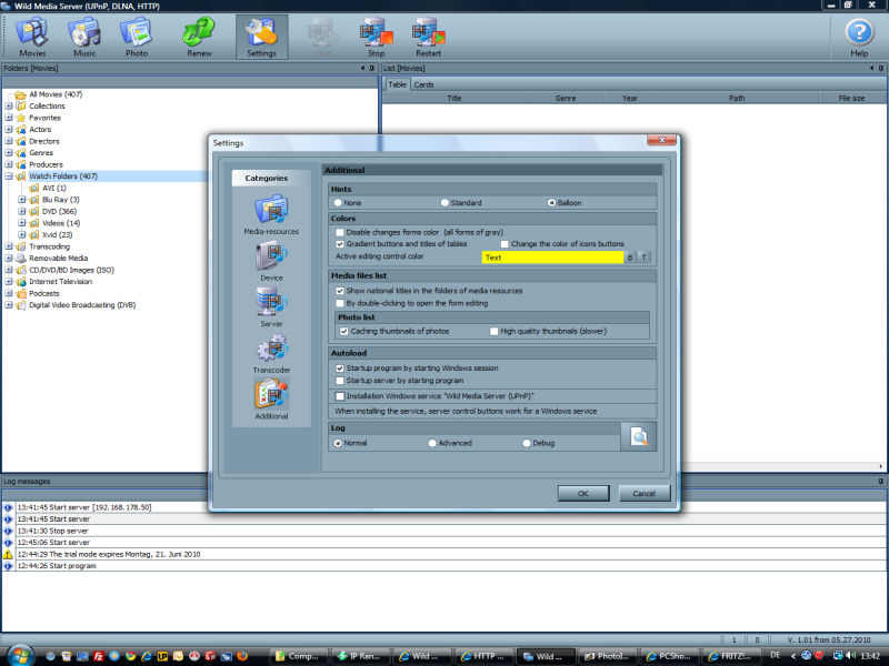

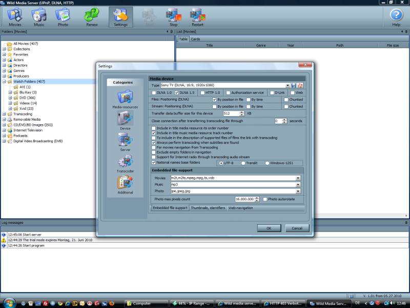

by wildone1965
Unfortunately still no access via webbrowser. Screenshot below
Re: Can't access WMS from Sony Bravia KDL 46 EX 505 TV
Posted: Sun Jun 06, 2010 11:49 am
wildone1965 wrote:Unfortunately still no access via webbrowser. Screenshot below
Settings-Server-"A list of allowed network connections" - remove all or add webbrowser computer.
