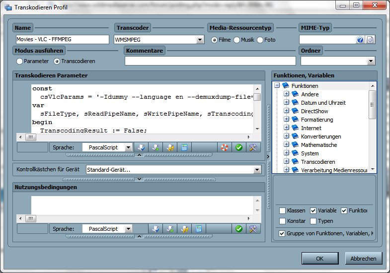

Hm. I've tried to change the media resource type in that above-quoted transcoding profile to "movies". Then I'm able to select this profile in the category "Internet Television". Unfortunately the test transcoded file (*.mpeg) only contains the audio stream - there is no picture. I'm sure that I've forgotten some important settings. Could you please help me again?
Thanks in advance four your reply.
Re: IPTV playlists
Posted: Mon Jun 07, 2010 7:18 pm
Klausi69 wrote:Hm. I've tried to change the media resource type in that above-quoted transcoding profile to "movies". Then I'm able to select this profile in the category "Internet Television". Unfortunately the test transcoded file (*.mpeg) only contains the audio stream - there is no picture. I'm sure that I've forgotten some important settings. Could you please help me again?
Settings - Transcoder - Profiles - Add
Name: Movies - VLC - FFMPEG
Execute mode: Transcoding
Language: PascalScript
  csVlcParams = '-Idummy --language en --demuxdump-file="%s" "%s" :demux=dump';
  sFileType, sReadPipeName, sWritePipeName, sTranscodingParams: string;
  TranscodingResult := False;
  if WmsCreateDualPipe(sReadPipeName, sWritePipeName) then begin
    if WmsTranscodingExecute('VLC', Format(csVlcParams, [sWritePipeName, InputFileName]), False) then begin
      if mpFileType <> '' then
        sFileType := '-f ' + mpFileType + ' '
      else
        sFileType := '';
      mpInternetItem := False;
      sTranscodingParams := WmsTranscodingProfileParams('Movies (Primary)');
      sTranscodingParams := ReplaceStr(sTranscodingParams, '<WMSMPEG> ', sFileType);
      sTranscodingParams := ReplaceStr(sTranscodingParams, '<INPUT FILE>', sReadPipeName);
      sTranscodingParams := sTranscodingParams + ' "' + OutputFileName + '"';
      TranscodingResult := WmsTranscodingExecute('WMSMPEG', sTranscodingParams, True)

Thanks for your quick response.
The test transcoding fails.
