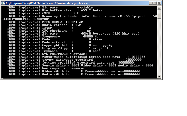

DEvil HUnter wrote:Movies (primary) - MPLEX:
The attachment mplex.png is no longer available
then getting an error, console windows are closing...
to fast to get screenshot..
MPLEX does not understand mp3, so you must choose mp2

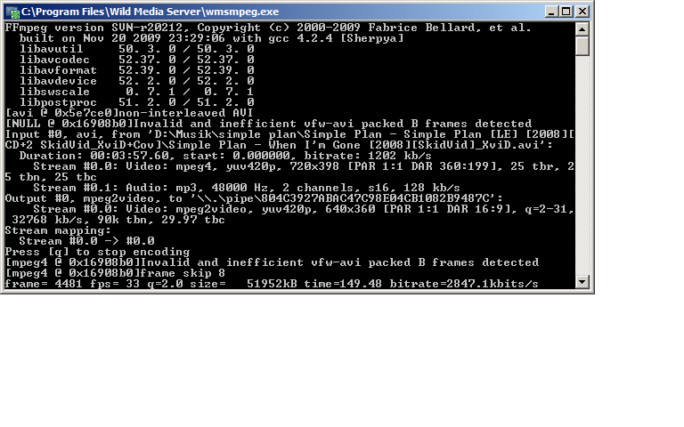

Movies (primary):
(this one i used before switching to vlc)
fps rate continiusly decreasing, holding by about 40...
vid is lagging extreamly...
Reducing the speed transcoding is normal, this happens because of this setting

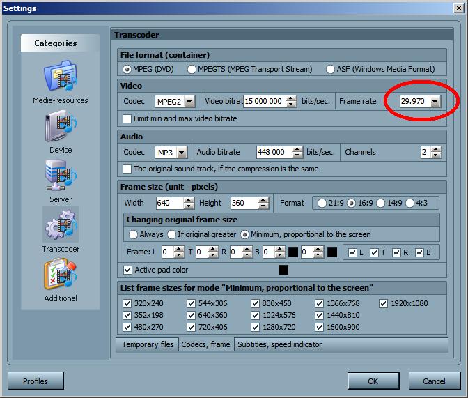

Perhaps the problem because of this,
- primary config1.JPG (78.19 KiB) Viewed 19680 times
it is better to clear this field

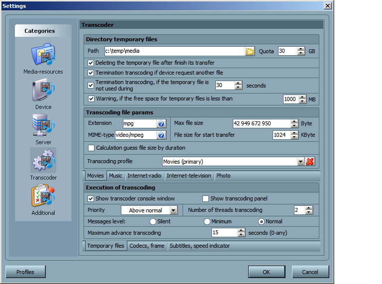

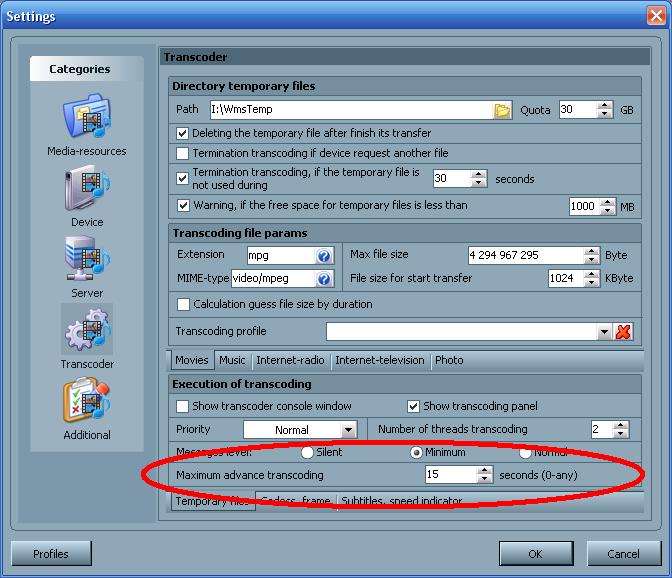

Recommendations:
1. Off mode "Termination transcoding if device request another file"
2. Set the field "Maximum advance transcoding" - 0
3. Clear field "Frame rate"
4. Do not use wlan (at least at the testing phase).
