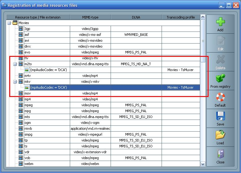

Samsung TV (DLNA, 16:9, 1280x720)
Settings - "File types"
You can make a similar settings

I viewed this topic before, and I have selected same device and file type are as if picture of topic completely :shock:
but I have problem for playing MKV file with DTS sound too :cry:
Re: LG 55LE8500
WMS: List [Movies] - select a file - right click - "Transcoding profile" - "Movies - TsMuxer" - right click - "Test transcoding" - check playback on TV
