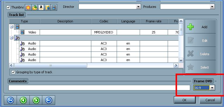

You can turn on the "For movies navigaton from Transcoding". (Settings-Device)
You can delete the vob-files from the list of supported (Embedded file support) (Settings-Device)
If the show is selected from the folder Original, then the file is transferred without any changes. TV cut away the dark parts of the frame. When transcoding, program complements the original frame to 16:9. If the original frame is a 16:9 in 4:3 frame, then in the movie information you can select 16:9 in the field "Frame DVD".
